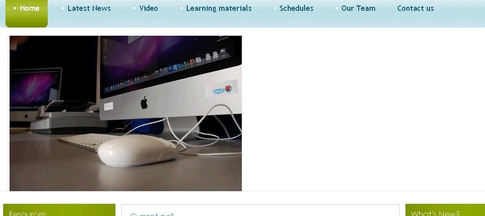

Hello, mtdmitchell!
I wonder if you could help me with a new question practically about the same.
The slideshow pics (RokSlideShow) that you helped me recently to modify are in the module User 3. But as you can see on the attachment here (printscreen), by using this module I leave a boring blank space on the right.
Any ideas how I could get rid of this empty space or maybe use it, extend the pics to the right as well? Is it possible at all?
thank you very much in advance!
