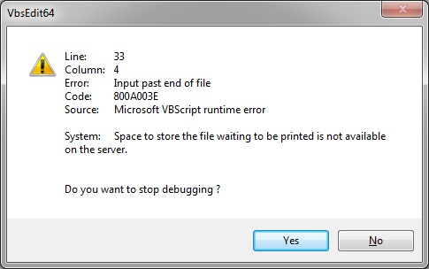

hey
i have just change the following and it works
Set rdFile = FSO.OpenTextFile(objFile.Path, 1,) to Set rdFile = FSO.OpenTextFile(objFile.Path, 1, TristateFalse, -1)
but i think it is still not full working as i am now getting this error when i run it
the full script is below

That error is usually when you've tried to read an empty text file.
Try using the code I posted earlier to read line by line (but remembering to use your new OpenTextFile code) and it should work
