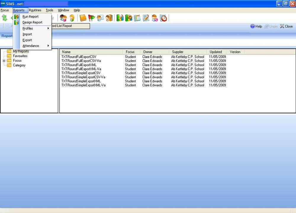

Unless the format it comes out in is particularly specific you would be better off with the student list reports that came out a few upgrades ago. I don't see the option in your image, which means you either don't have permission to run them, which is odd as they should be for all, or you are on a very old version of SIMS. Do you use custom permission groups?

That screenshot was one I grabbed from Google to show where I was talking about. The report is CES.
