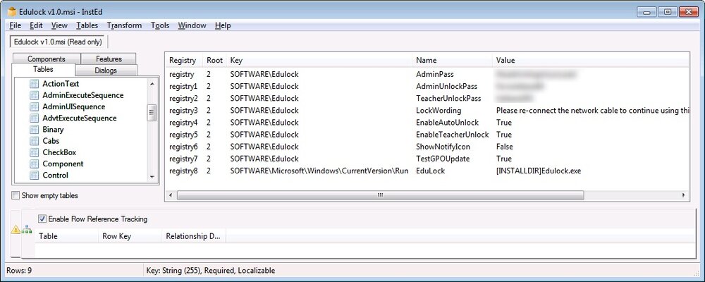

Hi Steve,
I've tried it on XP this morning to ensure it's not a Win7 thing, I get the same problem on both OS.
I've included a screenshot of the reg table from the MSI I am using to deploy.
If I give everyone Full Control, the error goes away. If I withdraw that permission, the error comes back.
Can you confirm you're setting those reg keys to: HKEY_LOCAL_MACHINE\SOFTWARE\EduLock

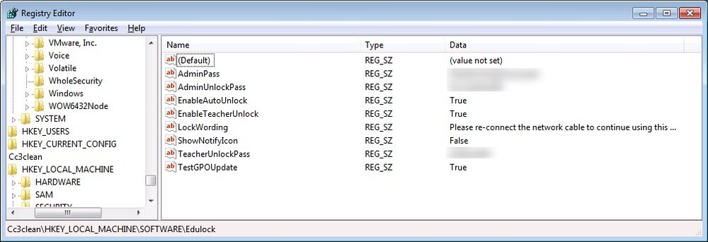

Looks good to me. Regedit screenshot below. Thanks for your perseverance.
[ATTACH=CONFIG]10568[/ATTACH]
Worked out what it is "I think" :p think it's me being silly.
  Dim regKey As Object = Registry.LocalMachine.OpenSubKey("Software\EduLock", True)
Is part of the line that reads the registry, and the true parameter opens it with write access. I'm assuming that's where it's going wrong as even though it's not writing anything, it needs access to open it like that.
