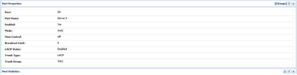

this is how it is set - the Reason LACP is set as disabled is becuase thats dynamic LACP which the switch works out which ports are together
whereas i have setup so that it specified which ports are in the trunk
that sounds/looks like it is the same as how I have our switch set for the ESX boxes.
