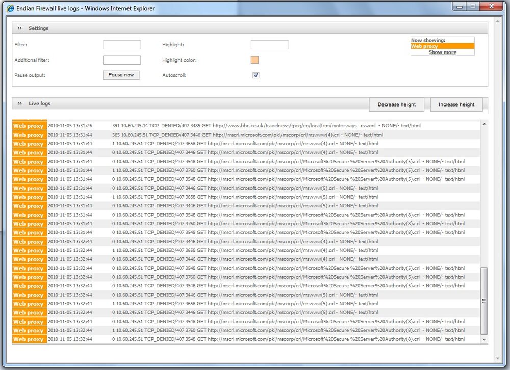

I do get TCP denied errors in the proxy log tho.

It does but to find out more i need you to SSH in to the endian box and get /var/logs/squid/error.log and paste it here because the log you shown is access.log
