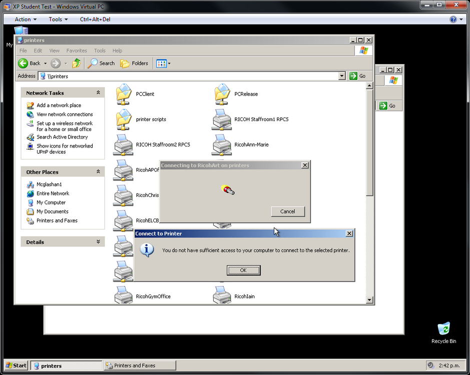

OK and we're back looking at this problem again...
We still can't run our normal Wsh script for adding the printers..
Furthermore, if we browse to the printers server as in the attached screenshot we don't have permission to add printers.
The MPM account used to create the mandatory profile can add printers this way. Student and staff accounts that use a normal roaming profile can add printers this way just fine!
We are using 2003 R2 as DCs and printer server, XP SP3 for the clients, we get the same thing happening on both a VM and on a real computer lab machine.
Any ideas?
