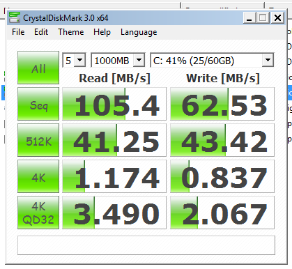

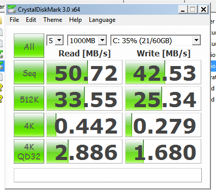

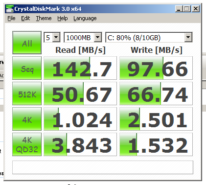

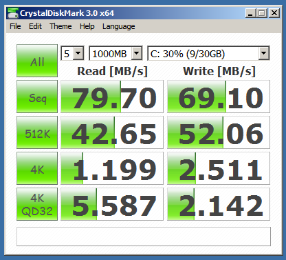

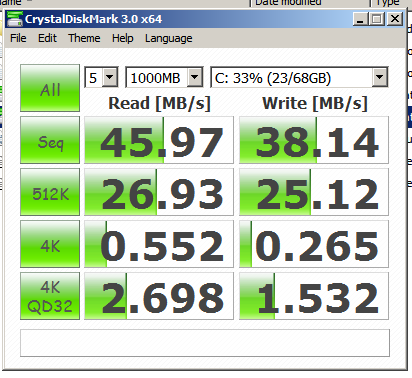

Ric_ Posted June 17, 2010 Posted June 17, 2010 Sorry for the delay in posting my results. I have benchmarkerd several VMs. 1. XenServer 5.5 running a 2003 x64 server (the only VM on that host's local storage) 2. XenServer 5.5 running a 2008R2 server (the only VM on that host's local storage) 3. XenServer 5.6 running a 2008R2 server (the only VM on that host's local storage) 4./5. XenServer 5.6 running 2 Server 2008R2 VMs on local storage I have only benchmarked the VMs I run on local storage so that I can get a fair comparison. All VMs have the relevant version of the XenServer Tools package applied. The XenServer 5.5 hosts have 2.5" 15k rpm SAS disks and the XenServer 5.6 hosts have 3.5" 15k rpm SAS disks. The 5.6 boxes also potentially had load at the time of testing. 1

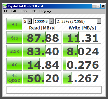

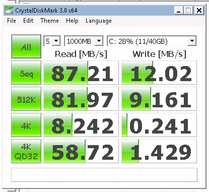

Ric_ Posted June 17, 2010 Posted June 17, 2010 Thanks Ric_ could you possible do one more test on a VM running on shared storage NFS or iSCSI? Cheers. Sure... I have no comparison between XenServer 5.5 and XenServer 5.6 though as the hosts using shared storage are both still on 5.5. I have attached benchmarks from a 2008R2 server and a 2003 x64. The shared storage is off a Sun Storage 7110 connected via a pair of gigabit ethernet connections in LACP. Both VMs were on the same host and under load at the time. There were 17 active VMs running from shared storage at the time of testing.
Ric_ Posted June 17, 2010 Posted June 17, 2010 Couple of questions Ric_: How are your Xen hosts connected to the 7110 (NIC configuration - bonded/teamed?) NFS or iSCSI? What type of volume(s) on the 7110? Thanks in advance Cheeky with 'Thanks in advance'!!! pair of gigabit copper connections to HP 2610G-24 and then a pair of copper links to each host. I have just 1 volume (a limitation at the time of setup) and it's set up as double parity RAID. As mentioned, I use NFS. I'm also using CIFS to directly serve files off the boxes too. Also see http://www.edugeek.net/forums/hardware/35639-sun-storage-7110-performance.html
