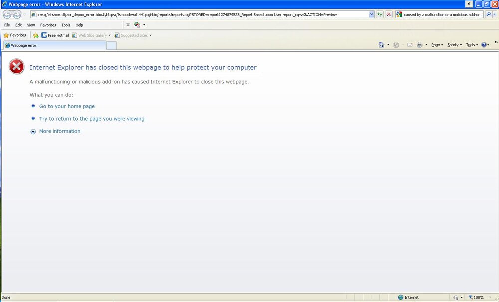

pwds Posted May 26, 2010 Author Posted May 26, 2010 Could it be anything to do with this? Oddly I found a way to consistently make IE do this, but that stopped after I installed Impero workstation on the computer. I did reboot the workstation as part of the installation though so that could just be a co-incidence.
