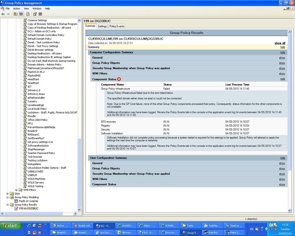

kennysarmy Posted May 5, 2010 Posted May 5, 2010 Since a power cut over night and the servers turning off at 3am I've been unable to get new pc's to the network to install software that they should do automatically via group policies and MSI's... screenshot of error attached... I've shutdown all the servers and turned the primary DC on first then the secondary then all other servers but the error and the issue remains... any ideas?

kennysarmy Posted May 10, 2010 Author Posted May 10, 2010 Thanks Richard, Yes I rebooted the edge switches for the area I am connected to in my office on Friday evening and it made no difference... DHCP seems to be running OK on the server...16% free addresses....uptime 114 hours Tested a client and ipconfig/release then /renew works OK. NSLOOKUP queries seem to me to return OK. What's the best way to confirm the replication process is happening between my servers? Also. I found this MS tech net article... How to disable the Media Sensing feature for TCP/IP in Windows This solves the 1054 errors on the clients...but I am not sure it's just masking a more fundamental issue on the network... Many thanks.
