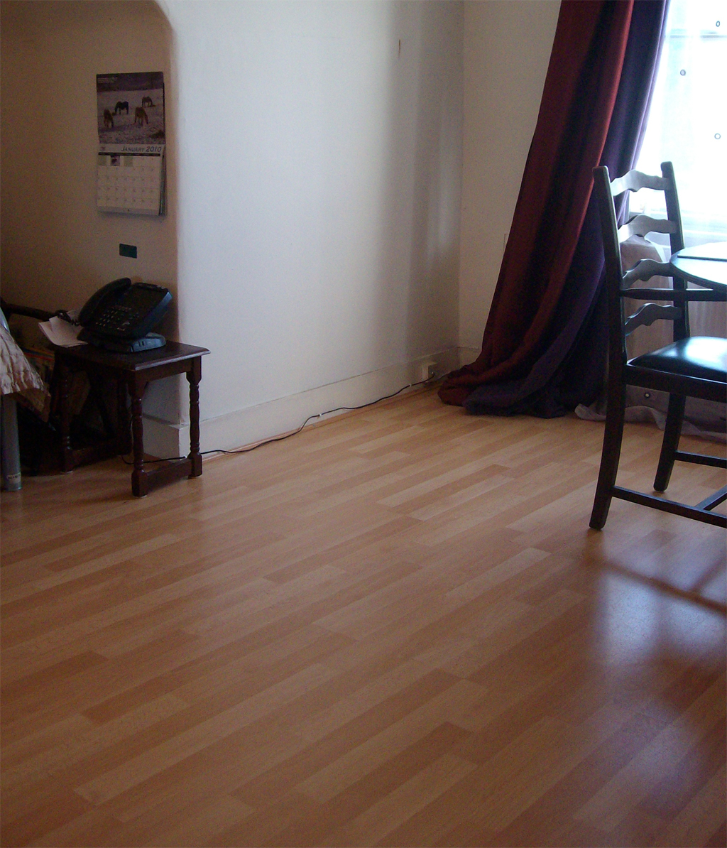

Great result
We'll see if it lasts - I'm just worried that I'll turn up in 6 months time and the boards will have expanded and pushed up, making great big lumps in the floor.
Phone cable could do with being tidied up a bit though
I ran out of those little white naily things.
David Hicks
