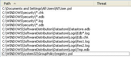

Have you added all of the recommended exceptions for the active scanning?
Yes:
All the machines in the Senior IT suite are now up-to-date with Windows updates, ensured by manually running Windows Update until it reported no more updates left to install. That's not all updates - there's still a bunch of Microsoft Updates to install, mostly to do with MS Office, but for some reason WSUS is randomly deciding it won't install those.
The machines are still freezing. Therefore, I figure Windows and / or NOD32 doesn't work and the proper solution is to wipe to whole mess off and install Ubuntu on the lot...

If I was a virus writer i'd be very interested in this advice.
Made me wonder, too, as I was typing the exceptions list in - I originally thought "Why not simply exclude C:\WINDOWS\security\*.*?", but then realised that would exclude executable files from being scanned. I think the list above should avoid excluding anything executable, and I think Windows still relies on file extension for executable status (unlike Unix, which relies on explicit executable permissions). A virus could, of course, store whatever data it wanted in a location excluded by the list, but it would still have to get on your system in the first place anyway, at which point you've already lost, so I don't think this list of exclusions is actually a problem.
