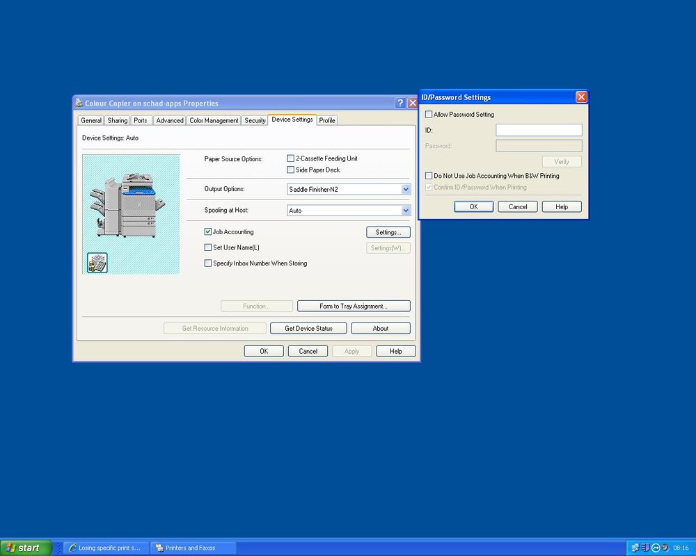

Are they are Canon's?
You'll need to set specific settings relating to Job Accounting in the Printer Properties, we need it on so each department can print rather than every print being charged to one department.
See attached.
We have Kyocera and Canon printers and some of the new print drivers require the codes to be put on the printers in advanced administrator settings and on the photocopier as well. If the codes are different or do not match you will run into problems.
