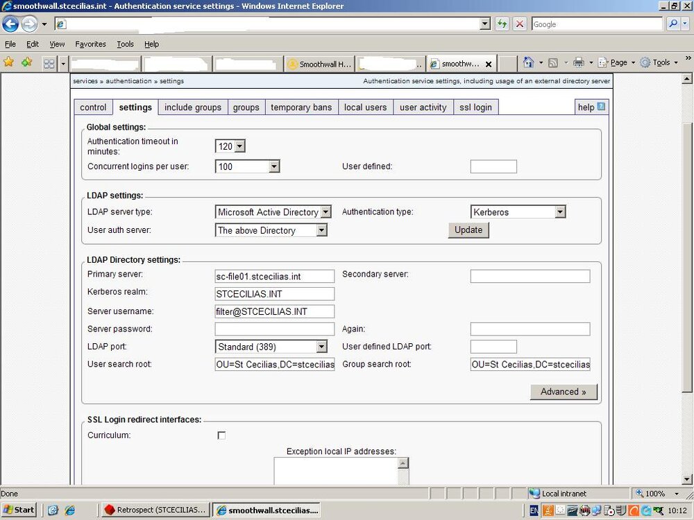

Check to see if your time settings are the same as attached. Set them as this, click save, then "get time now". Hopefully that should make it always right. If running on a virtualisation platform, you may want to increase the network time retrieval frequency if you are seeing gradual time skew issues.

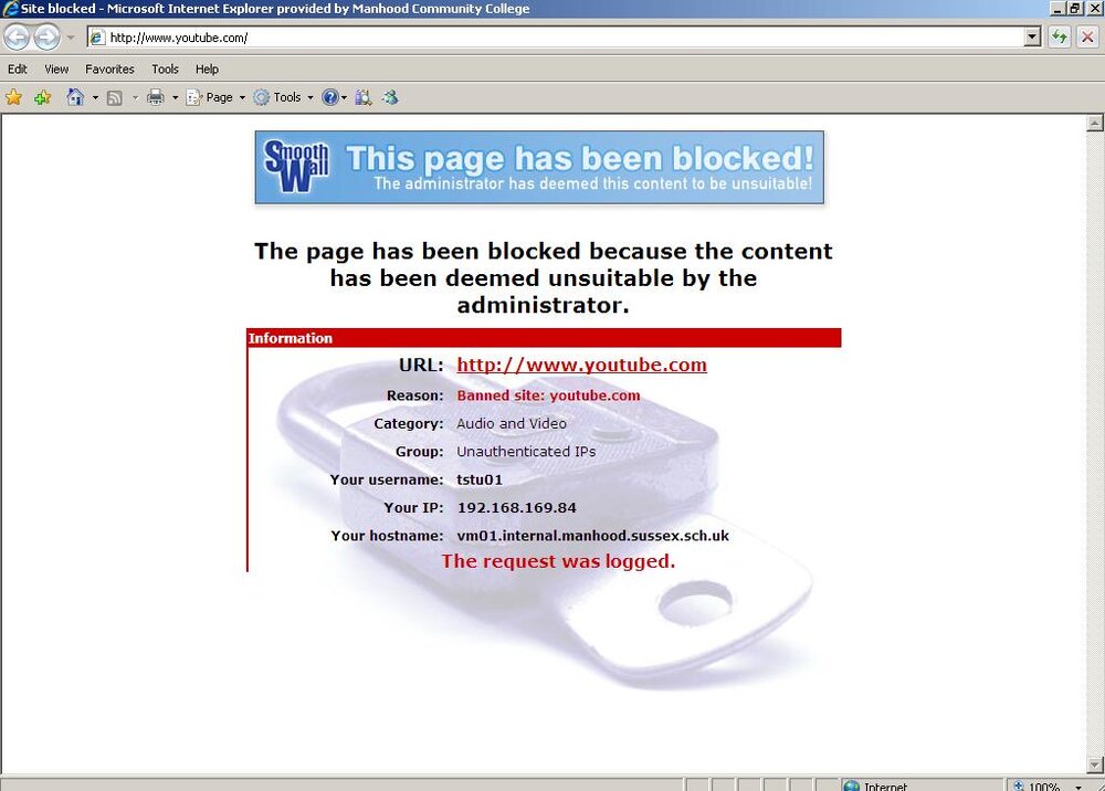

90% of my users are appearing as unauthenticated ip's when they get the block page instead of staff or students. I have set up groups called staff and students that match with my ad groups called all staff and all students. Why is it doing this??

Is there anything different about these 90%? It seems like they are not getting the NTLM challenge. Definitely *unathenticated ips* and not default users?

Attached is a screen shot of the block page i get logged in as my test student. There is nothing different about the users at all, it is affecting staff and students though so they are obviously different!

Hi Tom,

Have you restarted the smoothwall box? Sometimes ours stops being able to authenticate NTLM, I assume it's something to do with the machine account password expiring in AD.
Looking at the auth messages in the system log would be a lot more use for diagnostics.
