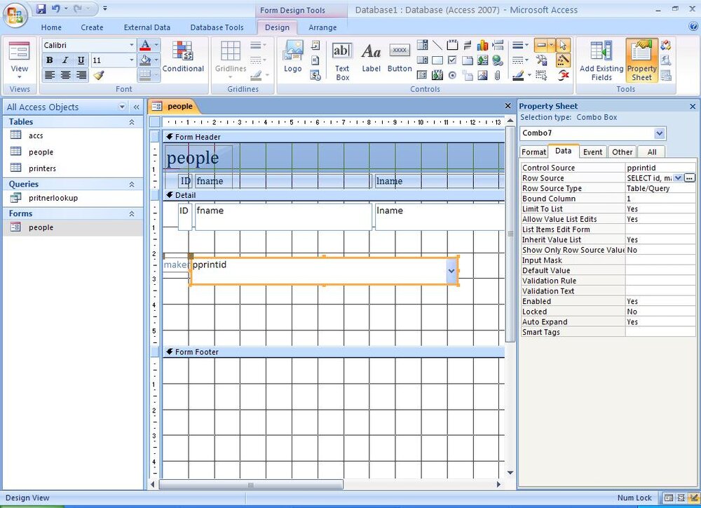

Open the form in design view, and select the combo box in question.
If it's not already visible, pull up the control's property sheet by pressing Alt-Enter, and click on the "Data" tab.
You should see something a bit like the first picture. Note the name of the control near the top of the sheet (Combo7 in this picture) - I'll assume it's called ConsumableCombo but it's probably something different on your form. You also need to know your form name - I'll assume it's Order More Stuff.
"Row source type" should be "Table/Query" (it probably is already in your database.
"Row source" is the query that pulls out the list of compatible consumables. To limit it to show only the entries you want, you need to add a WHERE clause to the SQL, in your example something like
WHERE tblConsumables.ConsumableName = Forms![Order More Stuff]![ConsumableCombo]
If you'd rather do this in Query Builder, you need to add a criteria (sic) constraint by adding the printerid field to the query and specifying "Forms![Order More Stuff]![ConsumableCombo]" in the Criteria field.
So far so good! However, the only catch is that Access is a bit stupid, and you have to tell it to change the combo contents when you view a different printer on the form. To do this, select the form itself by clicking in the very top left corner of the form (where the two rulers meet).
On the properties for the form, click on the "Event" tab, then click in the entry for "OnCurrent" and use the macro builder (click on the "..." icon) to add a macro. The macro is Requery and in the bottom, where it says "Control Name" enter the name of your control (ConsumableCombo or Combo7 in my mockup or whatever it is that you've used).
That's it! You should be good to go now.
Good luck,
Matt
