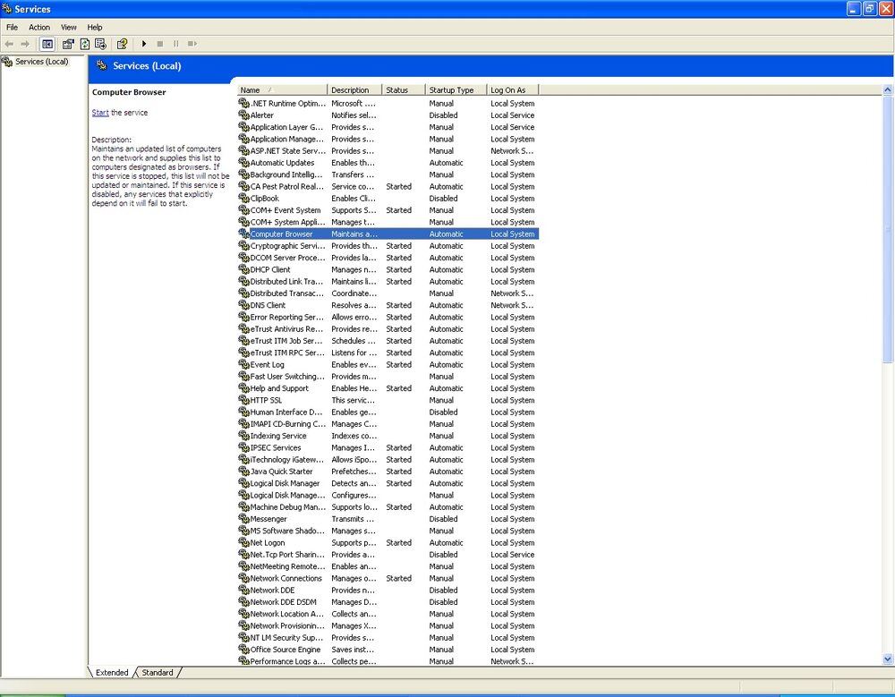

Hi there, I have a problem and I am pulling my hair out at this point. We bought some new (different) motherboards to replace broken ones in some of our computers (Gigabyte 945GCM-S2C) however I am creating a new image (complete re-install of windows) of these computers and the system is very sluggish and any users on the domain cannot login, so i logged on locally and following services that are set to Automatic are not starting - Automatic Updates, Computer Browser, Security Center, Windows Firewall/ICS,WMI and Winodws Time. After about 20 mins or so these services come to life and all is normal. Drivers are all up to date. Please help!!!

the netlogon service is running. This isnt just happening on one motherboard, cpu, memory bundle, this is happening on 10!

I have done an image and image the other computers with SP3 fully patched, but obviously it didnt work but I am doing a second re-install to fix the problem ready to create an image but this time i did it without sp3. Would you recommend taking off any of the .NET framework. In regedit HKEY_LOCAL_MACHINE\SYSTEM\CurrentControlSet\Control I made a DWORD ServicesPipeTimeout with the value 60000, this fixed the problem on next reboot, but on the reboot after problem happened again.
