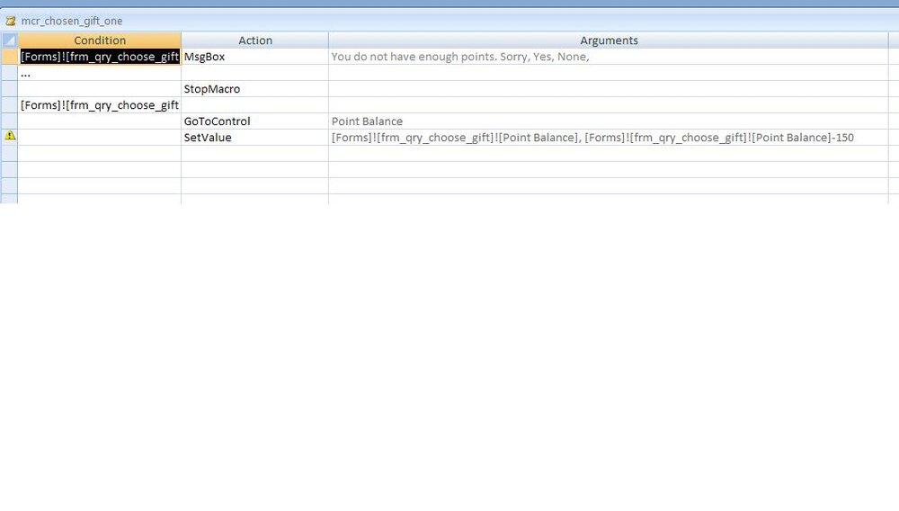

garethEds Posted January 26, 2009 Author Posted January 26, 2009 (edited) Hi, This one is bugging me now. I have put in a line with ... but even though the points are not there and we get the error message, it is still carrying on to remove the points - moving the user into minus points. This time I have removed the msgbox commands as they were just there for me to see how far the macro had progressed. So I have the first condition which checks to see if the user is less than 150 points. This works and gives the error message and stops the macro. However if the condition is false and the user has more than 150 points then the macro does not run. Screenshot attached. Gareth Edited January 26, 2009 by garethedmondson
SYNACK Posted January 26, 2009 Posted January 26, 2009 I think it is the blank lines causing the issues, you should have something like this without the blank conditionals or blank actions: Condition | Action <150 | MsgBox ... | StopMacro > 150 | GoToControl ... | SetValue ... | StopMacro 1
garethEds Posted January 26, 2009 Author Posted January 26, 2009 Yes that is correct. I've just hunted out my Access for Dummies book and on page 470 is exactly what you described. I added it and it worked. I then saw your posting. Brilliant. That works. Not to move on.... Incidentally on dbforums.com I've been told that code is the best way to do this - even though I don't want to use code at the moment. Amazing what you find on the web. Many thanks once again Gareth
