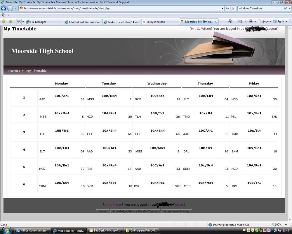

Anybody got a screenshot of it in use?

BTW for me to get it to work i duplicated the table and made the following changes:
From
$days = array('Mon' => 1, 'Tue' => 2, 'Wed' => 3, 'Thu' => 4, 'Fri' => 5);
$periods = array("" => 1,"1" => 2,"2"=> 3,"Reg"=> 4,"3"=> 5,"E4"=> 6,"L4"=> 7,"5"=> 8,"TWL"=> 9);
To
	$days = array('1Mon' => 1, '1Tue' => 2, '1Wed' => 3, '1Thu' => 4, '1Fri' => 5,'2Mon' => 6, '2Tue' => 7, '2Wed' => 8, '2Thu' => 9, '2Fri' => 10);
$periods = array("" => 1,"1" => 2,"2"=> 3,"3"=> 4,"4"=> 5,"5"=> 6,"6"=> 7,""=> 8,""=> 9);
From
$periods_labels = array("","1","2","Reg","3","E4","L4","5","TWL");
To
$periods_labels = array("","1","2","3","Lunch","5","6","","");
From
	$parts = explode(":", $row['period_name']);
To
	$parts = explode(" ", $row['period_name']);
The following changes are made in the duplicated table.
From
	echo '';
echo ''.$lessons[$i][$ii].'
echo $teachers[$i][$ii].'                               '.$rooms[$i][$ii];
echo '';
To
echo '';
echo ''.$lessons[$i][$ii+5].'
echo $teachers[$i][$ii+5].'                               '.$rooms[$i][$ii+5];
echo '';
Edited by apeo

I have had a look at your changes and i think I will be able to incorporate into code quite easily so the module supports both 1 week and 2 week timetables.
