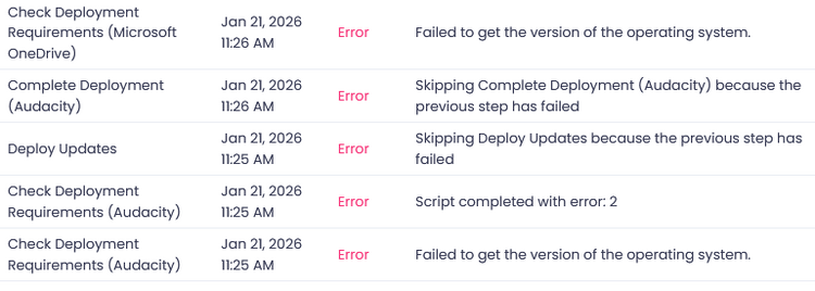

LeMarchand Posted January 21 Posted January 21 Loving Action1, but some clients are throwing a "Failed to get the version of the operating system" error. The below is from a suite machine; other machines in the suite seem fine. In the console the OS is correctly reported! Rebooting doesn't help and my Google-Fu has failed me. Anyone had and fixed this? It's bugging me!
TheHyperTechie Posted January 21 Posted January 21 WMI might be corrupted - https://learn.microsoft.com/en-us/windows/win32/wmisdk/wmi-troubleshooting 1

LeMarchand Posted January 22 Author Posted January 22 Thanks again to @HyperTech for pointing me in the right direction. For posterity, after working my way through less nuclear fixes what did the trick was: From Admin command prompt: >net stop winmgmt (Y to the "Really?" prompt) >Rename C:\Windows\System32\wbem\Repository Repository.old (You can also try to delete it) >net start winmgmt (Probably unnecessary as the next step to...) Reboot machine I had to reboot a couple of the machines that didn't want to do the rename to get it to take. This also had the bonus of sorting out the lockscreens that were defaulting to the Windows choice that was on the "must look at" pile. 1
