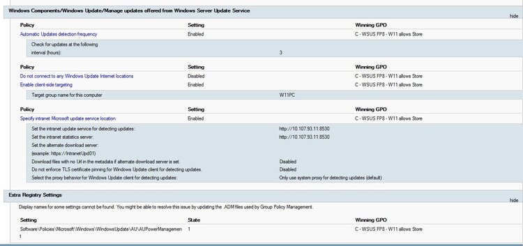

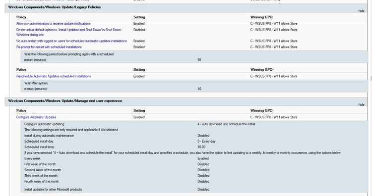

Is there any reason why these settings would have caused some PC's to restart after the MS update was installed this week?
See attached.
Had reports some PC's in a PC room restarted on Thursday around 4.25 pm.
One of the teacher emailed today to say:
However, I must say that my classroom PC (7A3)  started the install this week (turned off and restarted) on Wednesday after school (approx 4.45)  when I was still logged on- I found this unusual as I am normally asked about updates when I switch off the computer. I wonder whether it could be an issue with the update this week?
Looks like this is already been discussed.
edugeek.net/forums/topic/225608-kb5074109-causing-unexpected-reboots-on-install/
Glad it's nothing of our doing !
By restart do you mean to finishing off  the install of the update? when there set not to in working hours?  As i get this randomly since 23H2 on devices. however there is also the weird issue with this months updates causing reboots.
