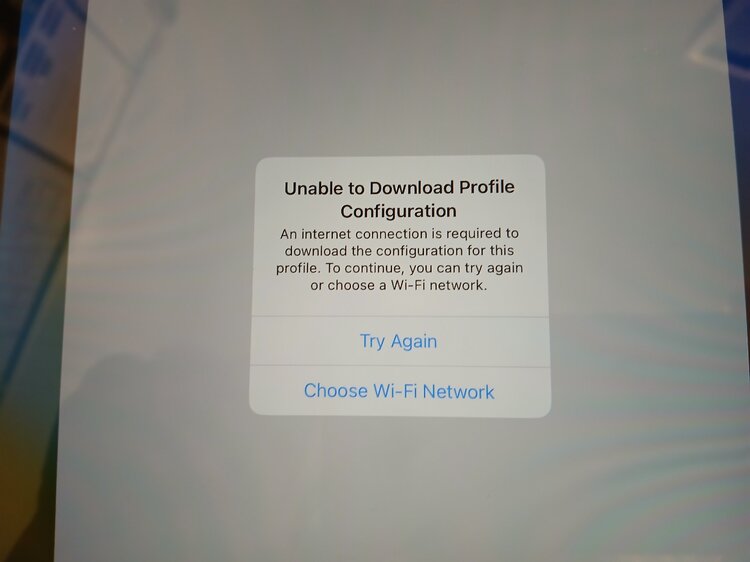

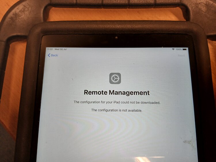

Every device I reset gets to the startup assistant, but then fails when it comes to enrolling into our MDM (Meraki) with either "Unable to Download Profile Configuration" (on iOS16) or "The Configuration is not available" (on legacy devices). This is stuck on a loop, we can go no further.

What iOS version are the devices you are trying to reset? See below error messages from two of ours, look familiar?

Odd that the messages are different, but, it could be that your message is particular to iOS15, as the messages I got for iOS12 and iOS16 were both different wording.
