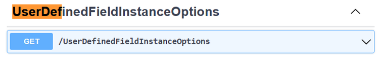

I want to write back some data to Bromcom using a PowerApp. Specifically write to a UDF.
As per the screen shot, how do I identify the 'userDefinedFieldInstanceId' which I assume identifies the specific UDF. I thought it would be the name of the UDF, but it looks like it's expecting a number.
Assuming I can configure this data correctly, how do I then send this to the API. Do I use an invoke-webrequest, and if so, how do I know how to format it?
At a guess, do a GET on UserDefinedFieldInstanceOptions first...
