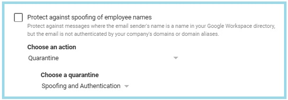

So, I went in to the 'Google Admin console > Apps > Google Workspace > GMail > Safety > Spoofing and authentication' and turned off each setting in turn and then tried to reset my Arbor password each time...
Strangely enough, the setting that seemed to work was 'Protect against spoofing of employee names' once that was unticked, the email came straight through to my inbox! I'm guessing maybe Arbor uses your username/domain to send an email to you, but from their servers...?

The only setting I have that directs emails to this quarantine, is the following:
Apps > Google Workspace > Settings for Gmail > Safety > Spoofing and Authentication
So, in this setting where it specifies the 'email sender's name' isn't actually the 'from' as I think from the header, this is 'Name of My School <[email protected]>'
I'm confused... why does it think the email sender's name is in our Google Workspace Directory...?
