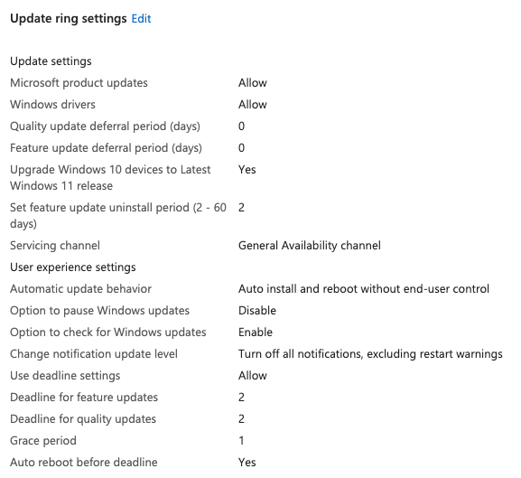

We are a Intune environment, fully AADJ and have been trialling updating Windows 10 Devices to Windows 11 using the update rings in Intune.
We set a number of devices to update using the setting 'Upgrade Windows 10 devices to Latest Windows 11 release'.

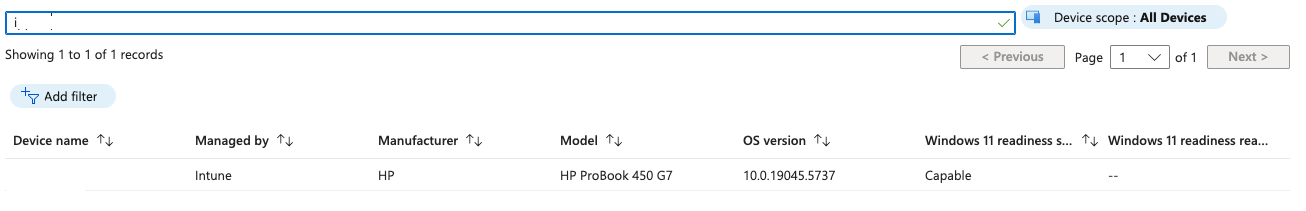

Probably a silly reply, but have you checked under endpoint analytics to make sure the computer(s) shows they are actually eligible to upgrade (e.g TPM enabled).
No silly replies at all at this point! Yep, all the devices we are having trouble with show that they are capable:

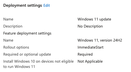

i do mine using the Feature updates tab, not the update rings tab, once assigned to the group takes a day for the update to appear.
We tried this also but the devices still didn't get the update...
Noticed your using 24H2, does it still not work if you use 23H2? As i have a lot of devices on site, which install 24h2 get to 100% in Windows updates settings then the updates just disappears goes back to check for updates like it was never there.

Thanks for this...have amended to 23H2 and will report back in a few days!
Looking like going straight from Windows 10 to 24H2 was causing us the issue! We are seeing the devices successfully find and update to 23H2. Thanks so much for this, saved us a headache!
