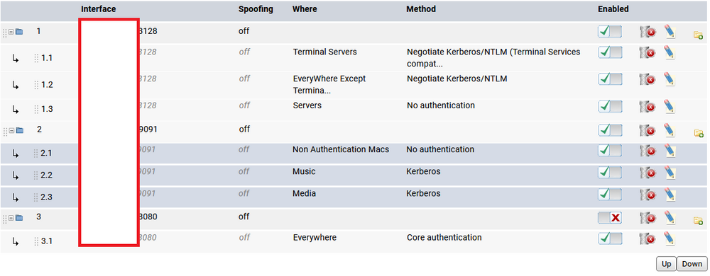

The proxy via edge seems fine , My issue seems to be Programs ( such as cloud drive mapper V3 ) cannot use the proxy , Doesnt seem to use the logged on credentials to authenticate .
Where as the browser does ?
Cant seem to find out what the issue is , Wondering if something has changed in regards to the authentication we are using . But i read the "Prepare to Update" sheet and i think we are fine ?

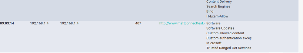

When using the Maiden proxy , i notice the following.
I believe the software uses the MSFTconnecttest url to check the connection
When i use our working Leeds proxy , the log looks like the following.
As you can see it goes in the "Unauthenticated IPs" group and displays the policys correctly.
I can browse to that site correctly via edge , Just seems to be when the computer calls the web address without using authentication.

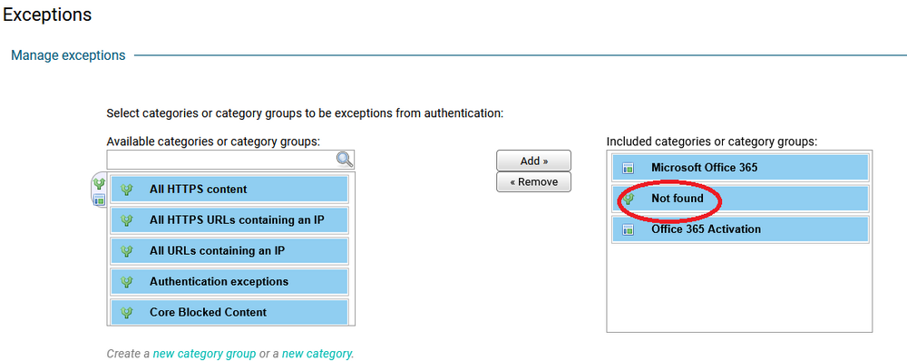

Seems i may have found my own answer .
After migrating my settings , it seems "Authentication Exceptions" has changed to "Not Found" . Once i removed and readded "Authentication Exceptions" , Everything now works as expected.
This article helped out
https://kb.smoothwall.com/hc/en-us/articles/360003755840-Default-users-Banned-users-and-Unauthenticated-IPs-Groups
I wouldnt nhave known to go there otherwise .
