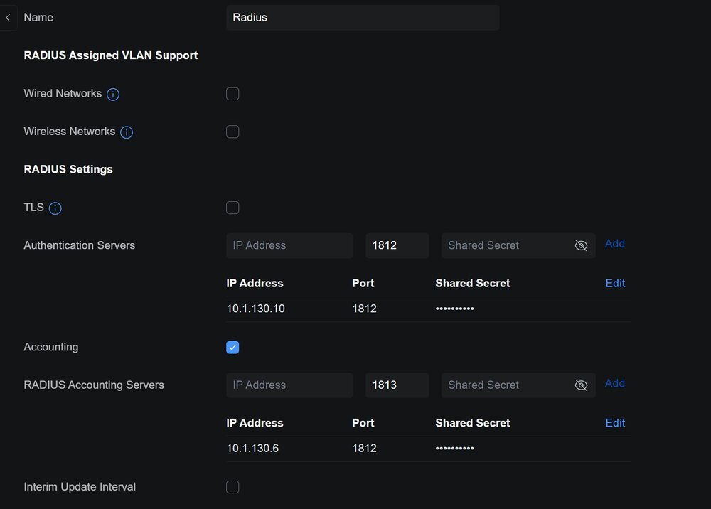

supportman Posted March 11, 2025 Report Posted March 11, 2025 (edited) I've just submitted this to smoothwall support, but wondered if anyone else has done this here? I'm trying to show usernames on our smoothwall safegaurding reports. Currently domain users show fine on reports but our BYOD users just show as an IP address. I've setup both Radius authentication and accounting our the Unify BYOD Wi-Fi side as so: so .10 is our radius server and .6 is our smoothwall server. But I don't know what to do on the Smoothwall side. Anyone done this before? Edited March 11, 2025 by supportman

PaddyNewman Posted March 11, 2025 Report Posted March 11, 2025 Sorry if being a sausage, but do you not want 1813 for accounting. 2
Netwacky87 Posted March 11, 2025 Report Posted March 11, 2025 (edited) Sorry if being a sausage, but do you not want 1813 for accounting. That's a very good point lol and probably why its not working! Don't forget to setup core authentication for your BYOD network. Should work fine then. Also, make sure you have RADIUS Accounting (1813) and Authentication (1812) enabled on the correct port under 'Network' > 'Smoothwall Access' Edited March 11, 2025 by Netwacky87

PaddyNewman Posted March 12, 2025 Report Posted March 12, 2025 All that happens is an accounting packet gets sent, I would assume they read the username and framed IP, and tie the two up. Going back to my other post, are you sure, 100%, SW is accepting accounting on 1812 and not the standard 1813. Transparent works, at least in Netsweeper which I imagine has a less refined (although functionally sound) RADIUS setup. Its a super basic concept.

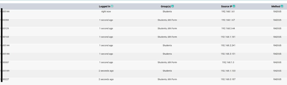

supportman Posted March 13, 2025 Author Report Posted March 13, 2025 (edited) [ATTACH=CONFIG]73274[/ATTACH] Big thanks for all your help with this one guys. It was actually staring at me right in the face after smoothwall 2nd line support noticed the packets were arriving on port 1812 rather than 1813. Its literally in the screenshot I posted although I think I was thrown off because Unify shows 1813 in the entry form but it was set to 1812. I simply changed the radius accounting port to 1813 in our unify setup and its all working perfectly now. Simple as that! We can now finally report safeguarding concerns for our BYOD network. A huge leap forward! Edited March 13, 2025 by supportman 1
supportman Posted March 13, 2025 Author Report Posted March 13, 2025 Got it working finally using the correct port for radius accounting and adding to the Smoothwall firewall. You can check in Smoothwall by going to Security >> User Activity The IP's should now match a username if its working.
