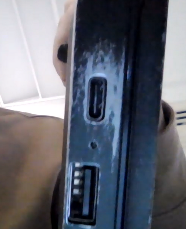

I have a laptop under warranty that no longer charges via the USB-C port - unfortunately this is the state of the charging port

This looks like user damage.
On the plus side, they are pretty easy to replace if you have the right equipment. Chances are there is a local electronics repair shop that will do it.
If you have multiple versions of that laptop take a photo of a laptop with the USB C port that's in the best condition, then either get an engineer to come out and fix it or send it off with another laptops back cover without the surface scratches near the port.

I didn't think about swapping the back cover - I'll look into it but unfortunately I think the S/N is on the back cover so they might notice if that's where they check the S/N and not the BIOS. However I have had laptops with the S/N sticker has peeled off (not sent any of them back though) so I might just peel it off and they can always check the correct S/N in the BIOS. Worth a punt I suppose! It does look user damage but I've had many of these USB-C failures so still think it is a design flaw, the member of staff who did it has been here longer than I have (20+ years) and never had any problems prior USB-C
If the chromebook looks like it's been thrown down a flight of steps then chances of you having a successfull warranty claim on a dodgy port are very low, and be careful as sometimes they'll charge you just for looking at it if it's purposeful/obvious user damage.
