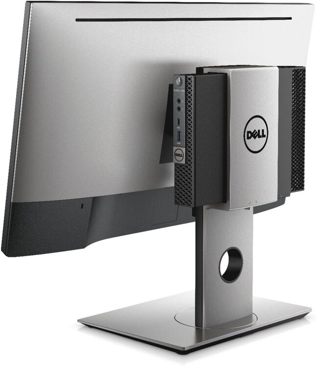

We have a lot of these DELL MFS18 stands with Optiplex 3060s inside and a 22inch Dell Monitor.
The monitors slot onto the stand and are secured at the bottom of the VESA with one thumb screw.
Someone (maybe more than one suspect) is deliberately reaching round and stealing the thumb screws. This means that when other users use the computers and attempt to raise the monitor up to suit their height, the entire monitor is falling off of the stand and falling towards their faces. As this is a primary school, the users are often short and small, particularly the really young children and I am quite worried that one of these 22inch monitors is going to end up really hurting a child.
Has anyone managed to source replacement thumb screws or other screws? I don't yet have an image of where the screw goes but just wondered if anyone else had similar issues. We have over 10 devices now in this state where the monitor is literally hanging by one small piece of metal as someone has had the screws away.

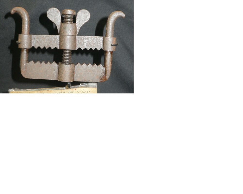

Dammit, I clicked on this thread because I was hoping someone had just actually worn out their set of thumbscrews which were being regularly used to dissuade children from fiddling with the equipment in the ICT suites...
Anyway I suggest you invest in a set to deter the little darlings!
[ATTACH=CONFIG]73111[/ATTACH]
Where can I buy these? Was wondering if they did ones with barbed wire on hehe
