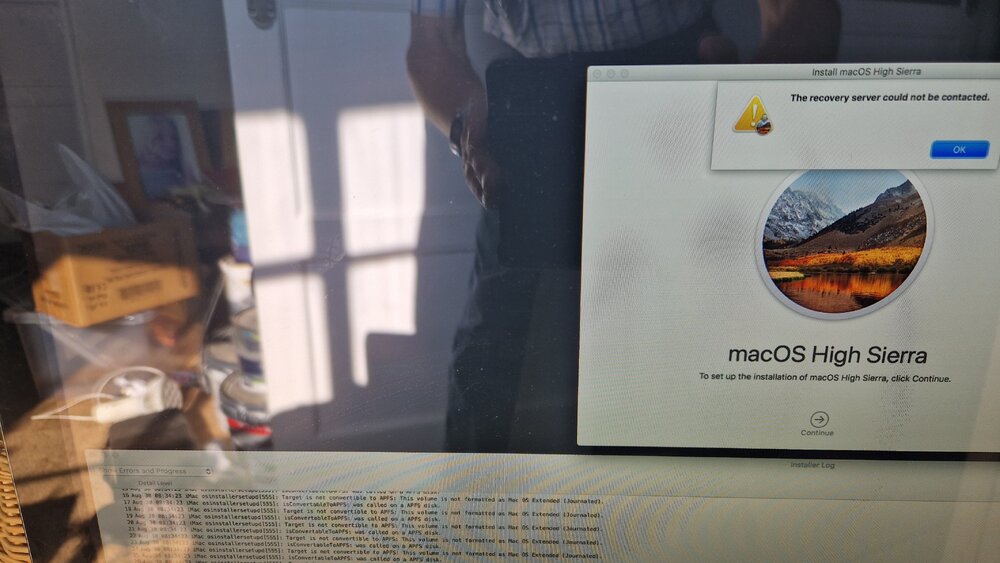

Have been trying to install MacOS from the Macs recovery software but it keeps saying "Server cannot be reached" ??
Any ideas to talk me through it !?
Cheers
I notice that is High Sierra, there is an issue with internet recovery and that specific version of macOS. This video should hopefully give the information you need to fix
It may not have the recovery partition in place, to install it from. Depends what was done to the boot disk.

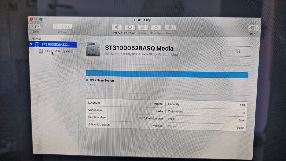

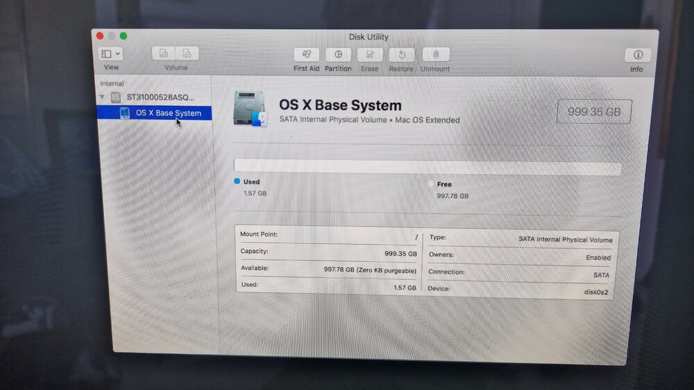

Here is a pic of hard dri ve sectors
Unable to erase any ?

To fix this you are going to need a bootable High Siera USB, which you will need another Mac to create.

You could also use Shift-Option-Command-R instead of Command-R on startup and it should allow you to install the macOS the machine shipped with instead of High Sierra. Which may at least get macOS back on the device which you can then upgrade or use bootcamp.
