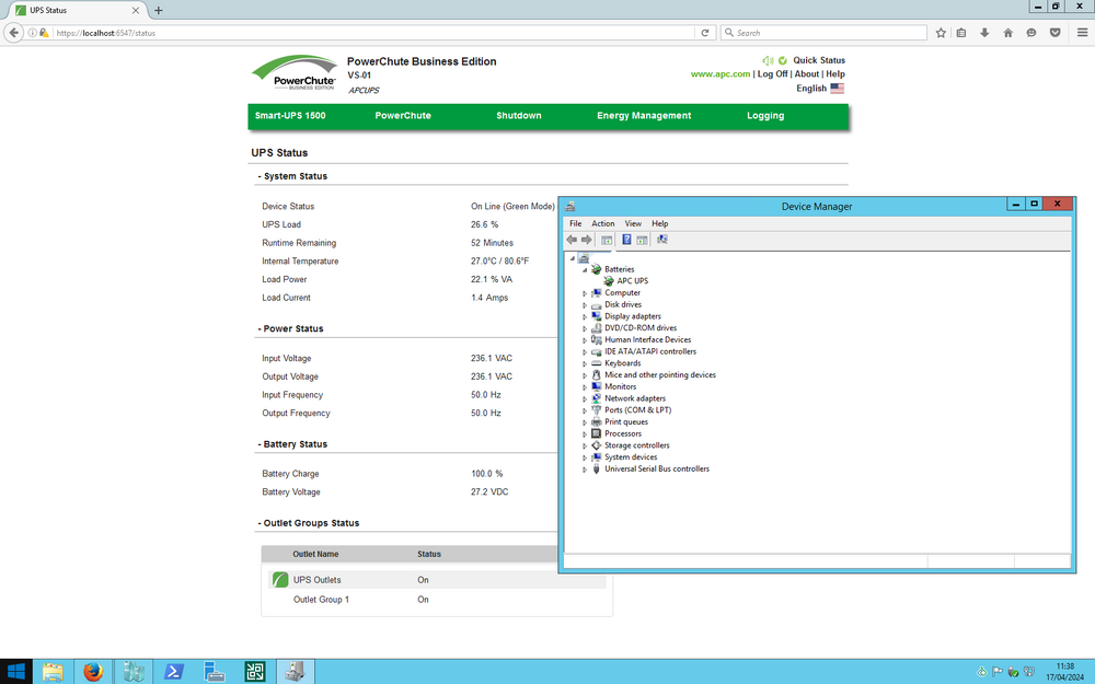

I think it may be because the UPS (APC) is USB connected and the PowerChute software for management is installed.
There's definitely 'UPS Battery' showing in 'Device Manager'.

No Battery icon, and setup is the same as you (USB connection + PowerChute).

Interesting... now I do seem to remember originally having the APC drivers and not seeing the battery icon!
Now I have this in Device Manager (using generic Microsoft drivers), which I stuck with because I thought at the time having the battery icon was a good thing...

Apparently they're installed as part of the PowerChute setup. Might be worth a reinstall or updating (mine was out of date). Or, if you use 7-Zip on the exe, there's a promising looking inf folder in $PLUGINSDIR.
