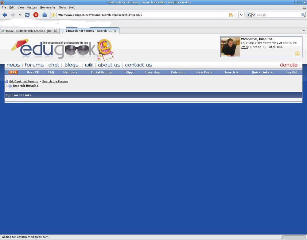

Interestingly the issue seems confined to anything related to the forums database on edugeek. I just checked and the blogs show up just fine at full speed but anything like opening up a thread or checking for new posts is consistently slow.
I don't know whether it like this because the blogs can be better cached and so get sent as one chunk or whether apache simply does not like keeping a connection open to NZ to send the requested files before it times out.
When the rest of the page turns up it does so quickly but the main chunk of the page seems to get lost on its way to me and so shows up minutes later. Stuff like page edits that are handled by AJAX seem to go through quickly to its just full page reloads that are affected.
Whatever it is, it is making the site infuriatingly frustrating :frusty: to use and if I was not already an avid user I probably would have given up trying to use it by now.
It's probably the ads. I don't normally condone this; but try blocking the ads and see if it makes a difference. Use Adblock Plus extension or disable Javascript and see if there's a difference.
Also try with images off, or loading some image urls directly to make sure it isn't a counter or other remote item thats slow to load. If you can find something that is making it slow then you could do a local dns entry in the hosts file to localhost or something to help.
Thanks, you nailed it. The ads were the culprit. The load times to get the actual content of the page is closer to 6 seconds rather than the 4-5 minutes that it was taking before. :D

Also, looking at page loads this morning, it stutters loading the 'top first' waiting for the ads and then pulls the page in.
Maybe the ad's provider is playing silly buggers!
Here we go, caught waiting 30 seconds for the page to load. Not your culprit, but another ad :(
traceroute to adfarm.mediaplex.com (64.158.223.128), 30 hops max, 40 byte packets

The 165ms isn't a big deal, it's more to do with the time waiting on the HTTP GET or whatever it's doing to pull the ad in, refresh and maybe catch another server and its OK.
