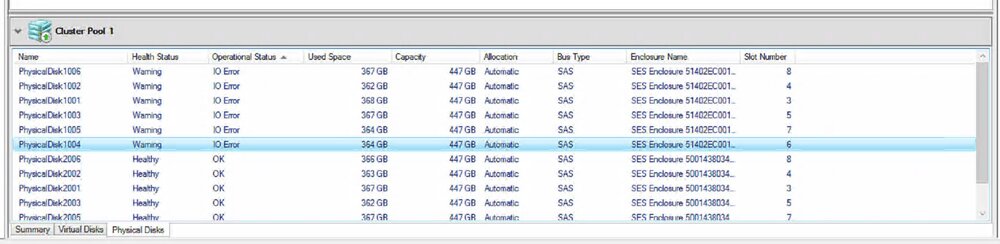

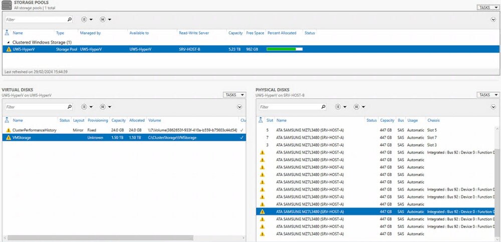

I've removed the server from the cluster, it's gone from the Enclosures list in Failover Cluster Manager, but the disks are still present but with no enclosure shown (Which makes sense).
In Server Manager>Storage Spaces however it's now showing double the amount of disks for the failed server when I view the Storage Pool, as shown here:
I restarted the affected server, which is when the drives appeared twice. I'm thinking I might be best leaving it for a abit, see what it shows later. I'm worried about removing the disks for the pool now it's showing them twice.
The status on the drives without a chassis shown, is 'Lost communication'. The status on the drives with the chassis shown is 'IO Error'.

Yes they do:
It's why I keep thinking the disks aren't talking to the OS/Cluster. So it doesn't know they have gone, or are back etc. Especially as it's all of them at once. HP Smart Storage tool however is reading them just fine.
Edited by robyholmes
Correct screenshot
So the node is completely removed but it's disks are still in the storage pool.
My best guess is it's a cluster issue not a server/disk issue as those disks shouldn't be showing.
