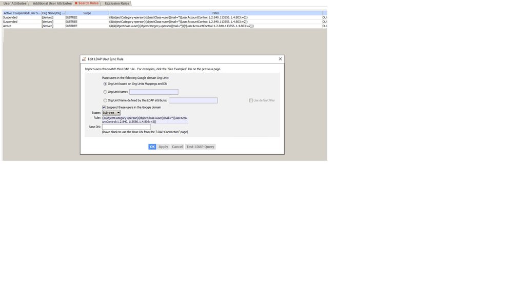

RLR Posted November 1, 2023 Report Posted November 1, 2023 From what I understand: (!(userAccountControl:1.2.840.113556.1.4.803:=2)) will only retrieve active users. Where as (userAccountControl:1.2.840.113556.1.4.803:=2) will retrieve disabled users (not sure if it also gets active users?). As this was a while ago I will say use this at your own risk! We also have several rules that point at specific OUs rather than doing the whole domain as our disabled users go into a leavers area so we only point the disabled users search to the leavers ou. I believe this is what we added: (&(objectCategory=person)(objectClass=user)(mail=*)(userAccountControl:1.2.840.113556.1.4.803:=2))
fiza Posted November 1, 2023 Author Report Posted November 1, 2023 From what I understand: (!(userAccountControl:1.2.840.113556.1.4.803:=2)) will only retrieve active users. Where as (userAccountControl:1.2.840.113556.1.4.803:=2) will retrieve disabled users (not sure if it also gets active users?). As this was a while ago I will say use this at your own risk! We also have several rules that point at specific OUs rather than doing the whole domain as our disabled users go into a leavers area so we only point the disabled users search to the leavers ou. I believe this is what we added: [ATTACH=CONFIG]70210[/ATTACH] (&(objectCategory=person)(objectClass=user)(mail=*)(userAccountControl:1.2.840.113556.1.4.803:=2)) That's strange because when I use the same syntax as your screenshot I get an error. If I add in another close bracket at the end then the syntax is accepted but when testing it returns 0 users.
RLR Posted November 1, 2023 Report Posted November 1, 2023 (edited) Have you checked to see what version you're on? You have slightly different options to me. Edit: You have an extra bracket "(" in your filter. It should be: (&(objectCategory=person)(objectClass=user)(mail=*)(userAccountControl:1.2.840.113556.1.4.803:=2)) Edited November 1, 2023 by RLR
fiza Posted November 1, 2023 Author Report Posted November 1, 2023 (edited) Have you checked to see what version you're on? You have slightly different options to me. Edit: You have an extra bracket "(" in your filter. It should be: (&(objectCategory=person)(objectClass=user)(mail=*)(userAccountControl:1.2.840.113556.1.4.803:=2)) So the existing filter has always had the extra bracket ) at the end and has always been like that. If i put in the expression the same as yours without the extra bracket then I get the syntax error as in my previous screenshot. It just doesnt make sense to me that it seems to work for you but not for me! With the extra bracket I get results returned. Edited November 1, 2023 by fiza
RLR Posted November 1, 2023 Report Posted November 1, 2023 I think your syntax is still wrong and you need two rules. One for active users and one for disabled users. There are two filters that look almost identical. One with a "!" and extra brackets and one without: Active users: (&(&(objectclass=user)(objectcategory=person)(mail=*))(!(userAccountControl:1.2.840.113556.1.4.803:=2))) disabled users: (&(objectCategory=person)(objectClass=user)(mail=*)(userAccountControl:1.2.840.113556.1.4.803:=2)) The disabled users rule should have the tick box applied to suspend users in Google. Again, I use seperate OUs for active and disabled accounts in AD so my rules point to these specific OUs. I'm not quite sure how this will work with if you point both rules to the whole domain but atleast there is a test button!
fiza Posted November 1, 2023 Author Report Posted November 1, 2023 I think your syntax is still wrong and you need two rules. One for active users and one for disabled users. There are two filters that look almost identical. One with a "!" and extra brackets and one without: Active users: (&(&(objectclass=user)(objectcategory=person)(mail=*))(!(userAccountControl:1.2.840.113556.1.4.803:=2))) disabled users: (&(objectCategory=person)(objectClass=user)(mail=*)(userAccountControl:1.2.840.113556.1.4.803:=2)) The disabled users rule should have the tick box applied to suspend users in Google. Again, I use seperate OUs for active and disabled accounts in AD so my rules point to these specific OUs. I'm not quite sure how this will work with if you point both rules to the whole domain but atleast there is a test button! I don't know what's going on! I have tried putting in a second rule with the same syntax you had and with one less bracket but I get the "unbalanced Parenthesis" error I posted earlier. If I put in the extra bracket then there is no error but gives 0 results.

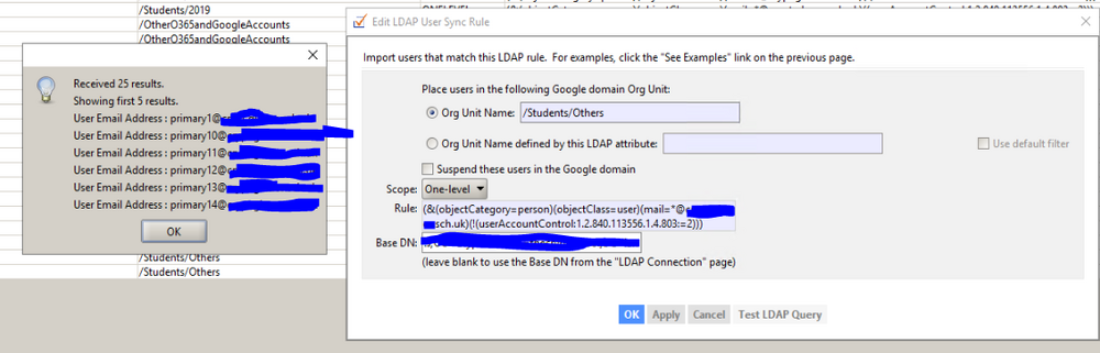

k-strider Posted March 21, 2024 Report Posted March 21, 2024 (edited) I know this is a slightly old thread but I’ve just realised that my disabled AD objects are not getting suspended in google. They used to work and we haven’t changed them it looks like it stopped about 6 months ago probably when I updated to GCDS 5.0.28 so we do 2 rules for each ou one for Active - Working and creates users & one to suspend Not working and when you test LDAP it returns 0 results for the suspended ones Active (&(objectCategory=person)(objectClass=user)(mail=*@school.county.sch.uk)(!(userAccountControl:1.2.840.113556.1.4.803:=2))) Suspend (&(objectCategory=person)(objectClass=user)(mail=*@school.county.sch.uk)((userAccountControl:1.2.840.113556.1.4.803:=2))) yes there is 1 user in the AD ou that is disabled. the Base ou is the same. ive tried sub tree and one level they both return results for active but not disabled. can i run the query in powershell against AD controller to see what it returns to me? just wondering where its broken. Edit if i put the query string into Saved Queries in ADUC it returns all my disabled users it schanges it to this but that also doesnt work in GCDS (&(&(&(objectCategory=person)(objectClass=user)(mail=*@school.county.sch.uk)(userAccountControl:1.2.840.113556.1.4.803:=2)))) Edited March 21, 2024 by k-strider
