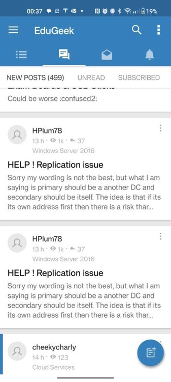

jmak Posted May 17, 2023 Report Posted May 17, 2023 Seems to be a replication issue in the Android app! 1
HPlum78 Posted May 18, 2023 Report Posted May 18, 2023 Ha clearly this issue is escalating, quick switch the internet off!
