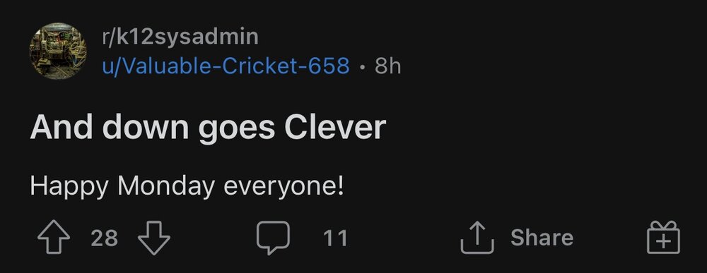

thimon Posted April 17, 2023 Posted April 17, 2023 I’ve also seen the platform go down a few times recently, meaning users couldn’t log in. It went down today.
Planehazza Posted April 18, 2023 Author Posted April 18, 2023 Thanks all, I'll keep all this in mind. I'm tempted to give this a trial, but does it seem that Clever has outages regularly?
