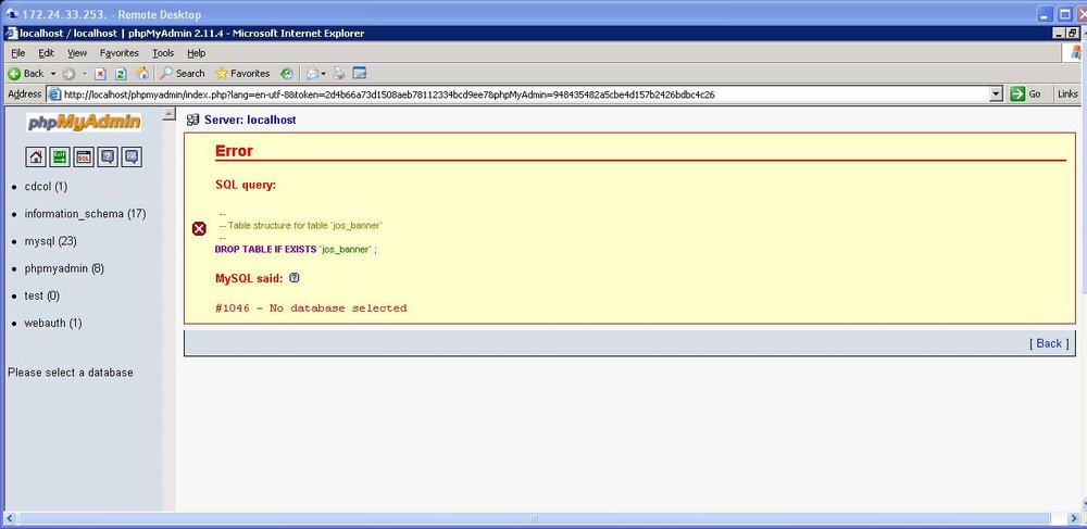

Hi
when i try to import a database that has been exported using the command i get the attached error message.
If works fine if i do it manually.
Any ideas please?
Thanks
Z
Are you using the --all-databases when exporting? If you aren't then you need to have a database selected before you try and import it, you could create a new test database for this purpose.
When I do an import I ignore phpmyadmin and just do it directly from the command line using something like:
mysql -h loclahost -P 3306 -u root --password=rootpassword testdb < c:\database\database.sql

I am using this one
mysqldump -u mysqlUsername --password=mysqlPassword databaseName > c:\locationYouWantToSave\TheDatabase.sql
I will try that tomorrow and let you know how i get on.
