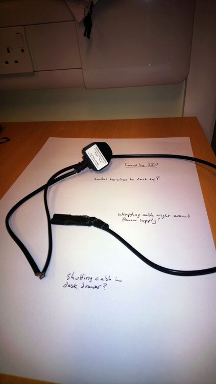

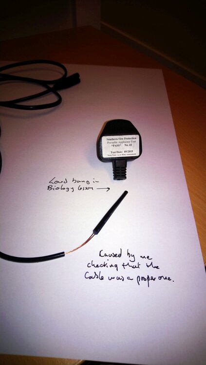

I'd certainly be wary of home devices being brought in. As a boarding school, ours are inspected (latest PAT guidance is class 2 need less/no "testing") These pics are the two I've had to deal with when there's been a bang and a loss of power to a lab.
