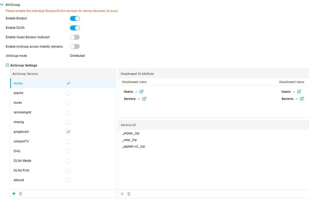

We are 1:1 with iPads and have Apple TVs in most of our classrooms. All our Wireless devices including laptops and 1:1 iPads connect to the same vlan/subnet as it uses 802.1x for authentication. We try to have an access point in every classroom. Most Apple TVs are connected via ethernet but some do sit on their own hidden Wifi network.
Our iPads can still see Apple TVs even though they're on different subnets/vlans. I wasn't the one that set this up so don't know the technicalitys of it but I believe it has something to do with our Wifi system, Aruba and their AirGroup service:
https://www.arubanetworks.com/techdocs/Instant_40_Mobile/Advanced/Content/UG_files/AirGroup/UnderstandingAirGroup.htm

When I implemented iPads and Airserver at a school we had the Airservers in a staff VLAN and the iPads in a Wireless VLAN to overcome Bonjour's VLAN limitations we looked at a number of solutions, the solution we came up with was to use a Bonjour gateway service on our Wireless network.
This was simple to set up and just worked the only other thing is as @Steve21 says the list of devices to connect to can become long however we just clearly named them and the staff where fine but I suspect mile could vary on this.
We only have half a dozen Apple TVs, on their own VLAN (possibly with the APs).
Our old (retired but still operating) Ruckus Zonedirector does the bonjour gateway to allow staff iPads to see the TVs. We do need to find a replacement before I bin the Ruckus as we're now all UniFi.
