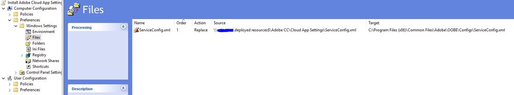

Giving this ago today, i can't seem to get it working. The file is being copied to the right location. But the cloud app isn't reflecting the changes. I can still see and install apps and updates.
Any ideas?
here's the contents of the .xml file;

Have you tried rebooting after you have updated the xml as it needs a restart of the CC app to reflect the changes and I found a reboot to be easier
I rolled it out during build in MDT after the install of Adobe CC - I have a "tidy" script for each app that cleans up the UI and applies any tweaks for the software that has been installed so I added a copy command into that to put the files where they are needed but I can't see why doing it via GP wouldn't work, as it's going into program files (x86) a computer policy would work

We have the CC desktop set not to load at boot (GPO). This works fine, however the apps aren't updating. When we manually start the CC desktop app it updates the programs and alls a good one.
However, the app still doesn't seem to be reading the deployed xml file. Students can still see and add apps outside on the deployed set.
