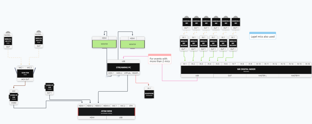

Bompalompalomp Posted November 16, 2021 Posted November 16, 2021 We've swapped to doing all of our events and daily assemblies via livestream, and invested £2-3k in equipment combined with what we already had for live events. I can send you our equipment list/specs if that would help? In short it's a combination of smaller wireless mics going via cameras on an HDMI switcher for assemblies, which can then be upgraded to using an existing mixer and software through OBS if higher quality audio or more than 2 mics are needed.
Danp Posted November 16, 2021 Author Posted November 16, 2021 We've swapped to doing all of our events and daily assemblies via livestream, and invested £2-3k in equipment combined with what we already had for live events. I can send you our equipment list/specs if that would help? That would be great, thank you.

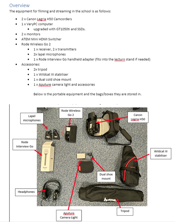

Bompalompalomp Posted November 16, 2021 Posted November 16, 2021 Mapped this out for you. Left side of the map is the standard assembly setup: Rode Wireless Go 2 with audio through the Canon Legria HF G50 camera, to HDMI out to the ATEM Mini which is connected to a dedicated PC for streaming via OBS. (No delay on audio as through the camera) For larger events with more microphones needed we can either connect handheld/lapel radio mics (or our XLR lectern microphone) to our larger 32 channel mixer that we used for live events, or the 16R rackmount mixer that's controlled via the presonus software, audio delay configured in OBS. MistServer Free version used for our internal livestream server. Cameras are around £800 ea. Rode mics around £250 for the two + accessories. ATEM Mini was around £250, but stock can wildly vary at the moment. Everything else major was existing owned from when we did live events/assemblies or repurposed. 2
slugshead Posted November 16, 2021 Posted November 16, 2021 Mapped this out for you. Left side of the map is the standard assembly setup: Cameras are around £800 ea. Rode mics around £250 for the two + accessories. ATEM Mini was around £250, but stock can wildly vary at the moment. We've actually rolled out ATEM minis, Rode mics and AIDA cameras in a bunch of our classrooms, simple once setup and the teacher just has to press one of 4 big buttons to switch the angles for students who are learning online
