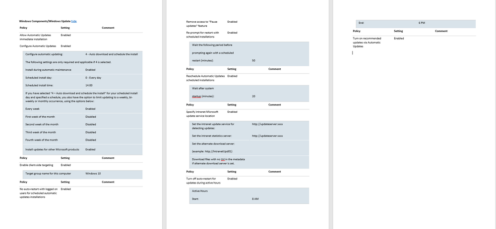

You mention laptops...... we have this issue with the odd wifi windows based laptop (we have Chromebooks mainly)..... We find the Windows laptops aren't "on" long enough to get everything they need from WSUS. We have a set time we download and install our updates from wsus.
I'm happy to post our wsus/windows updates GPO if any good to you?
Our cable connected machines are all 99% upto date. But these have a permanent cable connection. We also ask staff to leave machines on at the end of the day, as our classroom management software (ABtutor) shuts everything down at a set time and applies any pending windows updates.
The following are the basic settings I have applied:
Always automatically restart at the scheduled time – Enabled
The restart will give the users this much time to save their work (minutes) – 30
Configure automatic updating – Auto download and install
Scheduled install day – Every day
Scheduled install time – 15:00
Configure auto-restart reminder notifications (min) – 15
Specify the method by which the auto-restart required notification is dismissed – User action
Specify the period for auto-restart warning reminder notifications: Reminder (hours): 2
Specify the period for auto-restart immiment warning notifications: Warning (mins): 15
Specify the update notifications display options : 0 (default) – Default OS Windows Update notifications
Re-prompt for restart with scheduled installations – Enabled
Wait the following period before prompting again with a scheduled restart (minutes): 10
Reschedule Automatic Updates scheduled installations – Enabled
Wait after system startup (minutes): 1
Specify active hours range for auto-restarts - Disabled
We don't notify users of anything......... and have;
No auto-restart with logged on users for scheduled automatic updates installations Enabled
and
Allow Automatic Updates immediate installation Enabled (this installs updates that don't need restarts)
also
Turn off auto-restart for updates during active hours Enabled

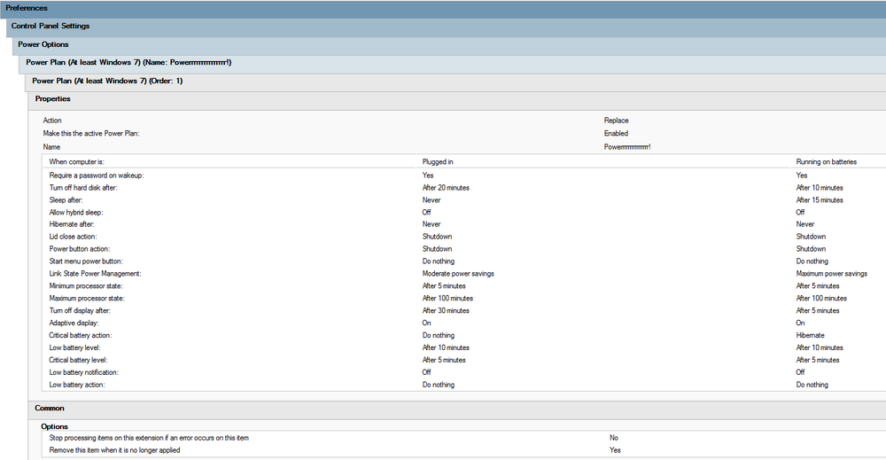

what about setting a GPO to "shutdown" laptop if lid is closed...... ideally, shutdown and apply updates if that an option

The only issue with shutdown on lid close is we end up with teachers wandering around the school with their laptops open, as they don't want to wait 30 seconds to startup again when they get to their next classroom/meeting...
