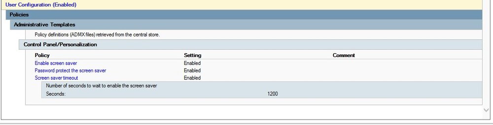

On this network no matter what setting via GPO I set to lock workstations it seems to not apply the GPO on a workstation and just always lock workstation after 5 mins of inactivity.
I've tried tweaking the settings under User >Admin Templates > Control panel > personalisation but absolutely nothing applies.

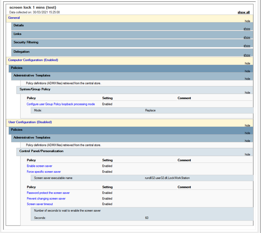

That's where we do it, though haven't had any complaints recently - maybe it's not working on W10!
We do have loopback enabled in the policy as it applies to a machine OU rather than a user one. (Not sure if that makes any difference).
It's showing the User section of that GPO as being disabled .... could that be your issue (presuming you didn't disable it as it didn't seem to be working) ?
Hi,
Thanks for noticing, That certainly won't have been helping (I disabled it earlier as was playing around a bit and forgot to reenable). I've re enabled it but still no lock out after 60 seconds currently.
Many thanks
Only other suggestion I've got off the top of my head, is it's not able to run the specific screensaver you're trying to get it use (most likely due to not finding the file specified). Try specifiying a different screensaver, or try fully qualifying the file path ( %windir%\system32\rundll32.exe user32.dll,LockWorkStation )

Just to update.
This problem is now resolved.
In all honesty after reenabling the disabled user config (thanks @MartinByard for noticing) then the policy applied this morning after a complete reboot. After changing the policy yesterday I'd only done a gpupdate /force not a reboot.
