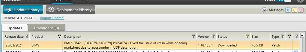

We had been running with those apostrophe's just fine until this update, but yes removing them fixed the crash. Unsanitized SQL inputs must have been the cause, a sign of very shoddy programming
yes, something in the Spring update broke it, there is now a patch out to fix it....

Have you got UDF's in the template with apostrophe's? That appears to be the issue....
