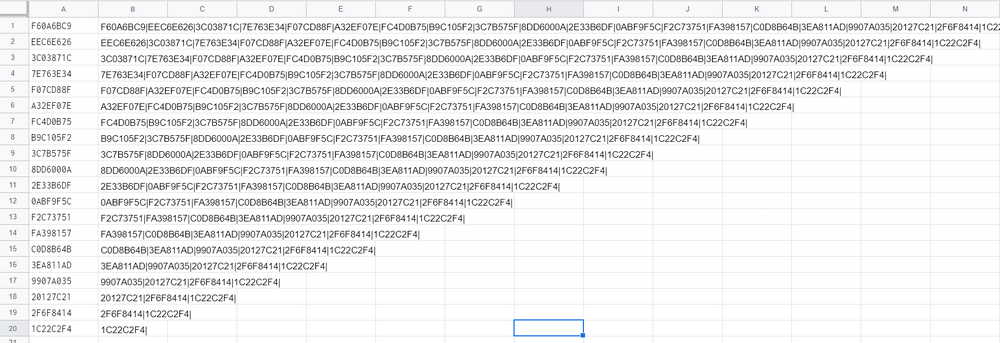

Quick Guide to getting it working, probably a bit over detailed but it might help anyone else that comes across this.
Start by setting up your form, The first section should just have your 'passcode' text question (set as required and without any validation rules) and nothing else (except maybe some introductory text). Create the rest of your form as required from section 2 onwards. Go into the settings and turn off 'Collect email addresses' this is not just for the form being anonymous but it would shift the columns in the result spreadsheet and that would require a minor code change. At this point you can create a response spreadsheet and open it up for editing.
In your spreadsheet you should have a sheet called 'Form responses 1' column A should be a Timestamp and B should be whatever you called your Passcode question with the rest of your questions following on.
You now need to create a second worksheet called 'Passcodes'. On this page you can create your passcodes in any why you like as long as the final string ends up in cell B1 (otherwise a minor code tweak is required). I used the following to generate the code in column A
=DEC2HEX(RANDBETWEEN(0, 4294967295), 8)
and in column B1 I used this formula
=A1&"|"&B2
I then copied it down to create my super long string in B1. After the codes are generated I copy and paste values over column A so the Codes don't keep changing.
With the spreadsheet set up we can add the script. From the tools menu of the spreadsheet select script editor. Delete everything in the right-hand panel add paste in the code posted above.
At this point you will need to put in the form's ID in line 21 this is the random string of characters taken from the URL of the form when in edit mode. We now need to find the unique ID of the passcode question on the form, to do that we uncomment lines 25 and 26. Save the code with the disk icon (you can also name your Apps Script in the top-right corner) and run it. The first run will take longer and ask you to authorise access to needed Google services.
The first run will fail (as we haven't found and put the correct question Id in line 29) but the execution log should show the titles of all your questions followed by their Ids.
Replace the Id in line 29 with the correct one from your execution log and comment out lines 25 and 26 again. Run your code again and it should complete successfully. You can check that it's worked by looking at the passcode question on your form, it should now have a validation rule with all your passcodes applied.
The final step is to get the script to trigger every time the form is submitted. From the script editor select the 'alarm clock' icon on the left-hand side to open the triggers page and then choose 'Add Trigger' at the bottom right. The Add Trigger dialog will popup, the only change needed is to choose 'On form submit' for 'Select event type'. Save the trigger and your form should be ready. Test it to make sure passcodes are being removed (if you delete responses from the spreadsheet the codes will come back the next time the script is triggered this lets you 'reset' the passcodes after testing).

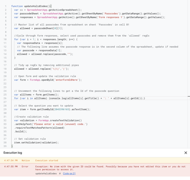

This is really great and I need it to work on my end. I'm trying but can someone help me with the below, I believe I had follow the steps properly but I'm assuming I might've missed something since this is what I am getting from the Execution log.
[ATTACH=CONFIG]62080[/ATTACH]
@Ditto is correct, line 21 needs your Form's ID number.
