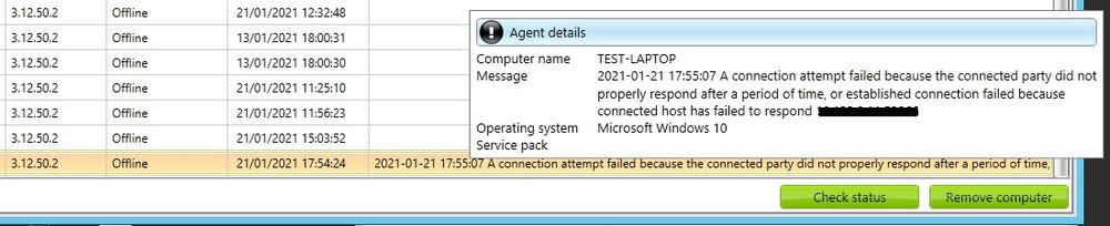

Trying to get SIMS and FMS updated for users at home.
Using LGfL Freedom2Roam/anyconnect (CISCO) if anyone knows it...
Using SIMS/FMS is no problem it seems, but updates refuse to happen.
Not sure if it is DNS related or what to do about it...
The translation is something like:
192.168.0.123 > 10.123.0.11 (this is the VPN IP recorded in DNS on the server for the laptop and can ping from the server using this IP).
The screenshot from SOLUS3 is also showing the correct VPN IP.
I don’t know if it’s the same issue we had previously but VPN clients don’t often update dns records so although it can ping via IP etc and it’s got a dhcp lease Solus won’t update it until you added the dns record and then it’d update fine
Can you ping the computer via hostname from the server ok? (You said about via ip) As if so guessing it’s not linked

If it's pinging fine it's unlikely to be DNS then.
Just noticed in your image it shows the clients offline too, Have you checked things like your firewall GPO for Solus rules (on clients/server) in terms of how you authorised the connections (was it limited to local subnet or anything etc)
Steve
Yes, the firewall was set for the SOLUS defaults (I'm sure that included specific ports etc) - but I've turned the firewall off now and it still fails...

How does the remote client authenticate? Radius? AD Direct? Separate VPN Login?
Can the remote client access the Solus Update repository through a normal Explorer/Command line route?
Solus now updates through our VPN but we had to do the following...
When the user connects their VPN, they run a very simple script to cache login credentials to the SIMS server shares, just by insisting on using their current login (felt weird, but it worked).
When the user joins the device to their home network, we had to adapt our Solus Agent Firewall rules to allow over Private/Public, which is what their laptop would end up in when at home.
For the couple of devices that still wouldn't play ball, they just needed to join the school wifi (often sat in the car park) and it updated normally.
I have updated remote laptops by exporting the updates and then running SIMSApplicationSetup.exe
However, if there is a way to use Solus to do the remote updates I would be very interested. What exactly did you change in the Firewall rules? I have a GPO which sets these up so I wondered if I could add the exceptions to this?
The changes to the Firewall rule for the Solus agent to work over a VPN was simply to apply the rule to Domain, Private, and Public network profiles. You can apply a firewall GPO in different ways but you get the idea that it needs to be applied to all three types of Network Profiles I'm sure you can work it out.
