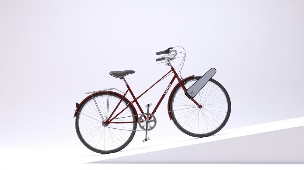

Thought this may interest some (@mikeprice?).
Wish your bike was an ebike, or would like one but think it would be a thief magnet? Clip have a $400 motor in pre-orders that can clip on and off your existing bike.
https://www.clip.bike/
Yankee, so probably £400 by the time they're available here.

Hmmmm
I have come across a lot of these things - and a lot of discussions about batteries, charging times etc etc
and this all looks a bit ambitious
firstly - friction drive systems were abandoned many years ago due to impracticability - and they tend to wear out the tyres like crazy and don;t react well to wet conditions
secondly - range is very limited - and there is a tendency to over estimate - but based on the charge time it looks dodgy - my bike can do about 40 miles on one charge - but it takes 4-5 hours to go from flat to fully charged - if this can charge in 45 minutes the battery capacity is quite low
but mostly - the motor power is claimed to be 450W - which is not road legal in the UK or EU
and, of course, it looks terrible
There are loads of upgrade kits for bikes ===> ebikes on the market - you can convert a normal bike to ebike for cheaper than that
