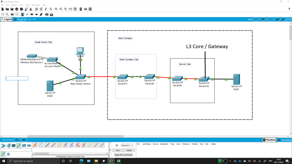

Just inherited a problem at a site that has a main building complex then a small centre about a 1KM away that's physically linked by a dedicated leased line. The overall issue is that the centre has no network connectivity, whereas the main complex is fine. The entire network is logically segmented into VLANs . Everything in the centre is configured to feed off the main complex (i.e DHCP, DNS, WiFi, Internet etc.) where all of the core devices reside. Core devices (servers, switches, router etc.) sit within VLAN1 on a 10.12.12.0/24 network. Backbone consists a mixture of Cisco SMB, TP-Link and Netgear switches all with static IP's. RSTP has been enabled on all switches. A L3 Cisco SG300 is set as the gateway and carries out the inter-VLAN routing Gateway IP exisits for each VLAN and DHCP helper has been enabled and set to the main DC. The main DC (DC01) is situated within another cabinet in the main complex away from where the link between both buildings comes in, so at present, there are several truncated switches in between to the main DC. This handles all VLAN addressing. They do have a failover DC (DC02) that is situated at the centre. Both have static IPs.
Now, I can ping DC01 to DC02 and vice versa and I can also remote into DC01 and RDP over to DC02, so I know for sure that the physical link is intact. However, I can't ping or access the centre switch IPs from DC01, however, I can ping and access any switch for the whole site from DC02. I don't see how I can ping and remote from DC to DC but can't ping the centre switches from the other side as I thought that by default, all untagged packets would be associated on VLAN1, where all the core devices sit plus traffic must go through switches on either side or order for me to connect from DC to DC. This might need some clarification on how this works.
Today was just a fact finding mission so I should have the tools and access to troubleshoot going forward. What I have checked so far is making sure all switches and truncated ports are set correctly, set to trunk then VLAN1 as untagged with all other VLANs as tagged. What I would like to test is where traffic is potentially being dropped and/or if VLAN ID's are traversing across the leased line correctly. Traceroute doesn't work for anything internal as it either drops straight away or shows me 1 hop which i would expect. Be interesting to know if anyone has had experience with Wireshark to set this up and point out what I would be looking for. Also below is a basic visual representation of the ping tests I have carried out:
DC01 <----> DC02 - OK
DC01 <----> Main Centre Switch - Unreachable
DC02 <---> Any Switch - OK
Like I said, main complex is fine but for some reason, no devices connected to the switches in the centre can obtain a DHCP address from it's respective VLAN, even when connecting to a port I've set to VLAN1, but I can communicate from DC to DC.
Just wanted to brainstorm potential causes and ideas on where and what to troubleshoot to see if I can find anything glaring or missing. Any tips and/or explanations would be greatly appreciated.

Can you confirm that the main centre switch, DC01 & 02 are all in the same VLAN?
How is the link between the sites configured? Is this an access port of 802.1q (trunk / tagged)?

I will whip up a diagram when I get the chance. Just walked into this issue this morning with scarce documentation apart from a list of switch credentials and truncated ports so I have the outlay of the network in list form.
DC01, DC02 and the main centre switch all have static IP's within VLAN1 IP scope and connected switch ports are set to access with VLAN1 as untagged.
The link is a single strand fibre that connects into a ADVA FSP150CP optical fibre access switch on either end which are then connected by multimode fiber into a SFP switch port. These switch ports are set to trunk with VLAN1 untagged and all other VLANs tagged.
Below is the diagram for it:
https://ibb.co/mDkXGMn

Also here is a very quick and basic network topology, if you need me to go in more depth then I can, it's just what I could muster up in the time. Like I said, all devices have static IP's within VLAN1 IP scope. I am positive I have checked all truncated ports to ensure they are trunks with VLAN1 untagged and all other VLANs tagged.
Took another visual look at the truncation today and the activity on the switch port LEDs did seem very erratic to the point that they are constant. Was mainly looking at Cisco switches so don't know if that's how they usually behave but did seem a little full on. Could I be looking at a potential network loop somewhere or do you think I am clutching at straws?
Any other suggestions or troubleshooting roads I could go down as I am starting to run out of ideas.

Sorry was wrong about the /32 subnet below hadnt twigged it was your link.
I think you need change your subnet mask on vlan 2 /32 only allows one ip, and you are using 10.11.0.1 and 10.11.0.2
Edited by PyROm
Thinking about it, you have used the same 10.12.12.0 at both sides of the link, you cant do this with your setup as you are routing the traffic. Traffic matching a machines local subnet wont be sent to a gateway (normally) and even when it does the router wont know which end of the link to send it to. You need to change the subnets at one site so they dont match the other end. This will mean a second dhcp scope etc.
