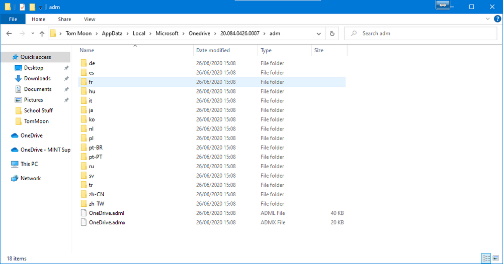

supportman Posted July 1, 2020 Report Posted July 1, 2020 I use this GPO along with Azure AD sync. Automatically logs each user into the Onedrive client and enables files on demand so the drives dont get filled with everyones stuff. Works really well. [ATTACH=CONFIG]58480[/ATTACH] I cant find that GPO setting, do you know where it is exactly?
tmoon-mint Posted July 1, 2020 Report Posted July 1, 2020 I cant find that GPO setting, do you know where it is exactly? You will need to get the ADMX templates from a machine with the Onedrive client installed. Its in %localappdata%\Microsoft\OneDrive\(folderwiththehighestnumber\ADM Inside you should find onedrive.admx and onedrive.adml copy these to policydefinitions folder on your DC and they will show up in administrative templates > Onedrive 1
