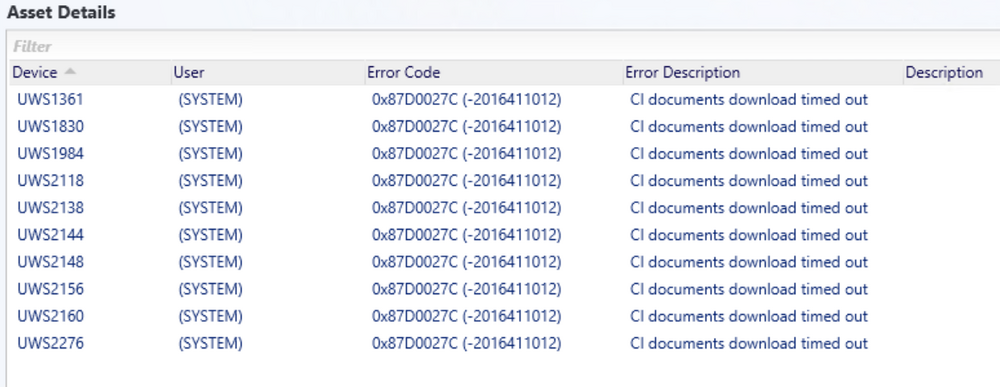

However, my deployment is still not reporting any successful installations. It has 4 which show 'Couldn't detect the software after installation' and then 10 machines showing this:
CI documents download timed out
I've found a few references to this online but mainly to do with updates which state its an update which has been superseded. I'm deploying the OneDrive client (Downloaded just before deployment last week) with the /allusers set. I detect if its already installed by checking for the exists of the onedrive.exe file in Program Files.
I'll try have a look at logs on the clients but it might also just need time to sort itself out. Just be nice to have at least one machine show as 'Successful' to prove I've got it setup right.
