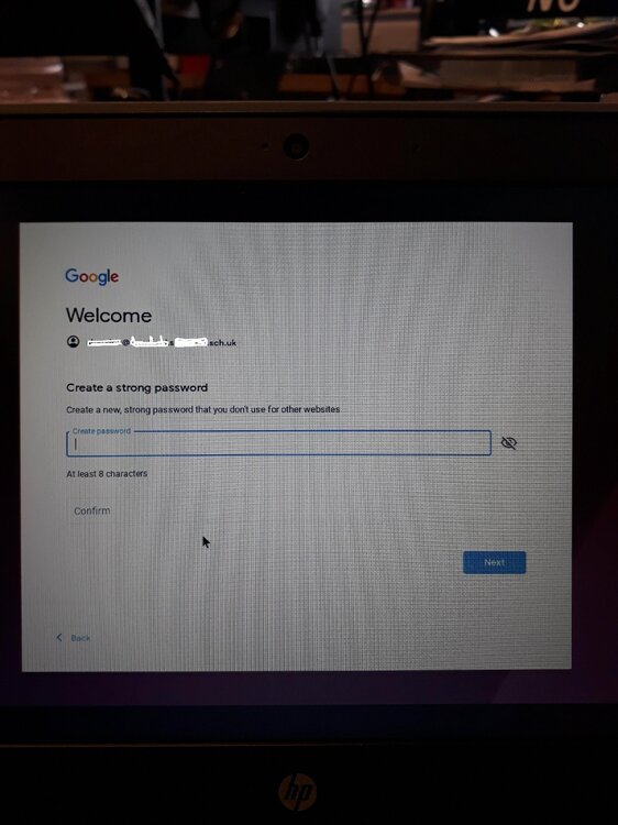

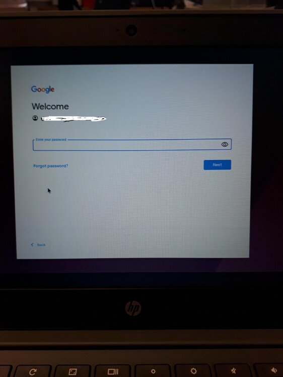

GoatSheep Posted May 14, 2020 Posted May 14, 2020 Morning, I have created a GSuite domain and setup Google Directory Sync and password sync. I understand that the AD password needs to be reset in AD before I can log into google services. If I open a browser and sign into google, on screen 1 I enter username (fine) on screen 2 enter AD changed password (fine) but then I would expect to be logged in. Instead screen 3 asks "Create a Strong Password" If I look at the user in Gsuite it says the user has never signed in. If you create a strong password then the user appears as having signed in but the google account is now using the new password not the AD password. How do I stop Google from asking me to create a strong password? I am waiting for Google to get back to me. Thanks

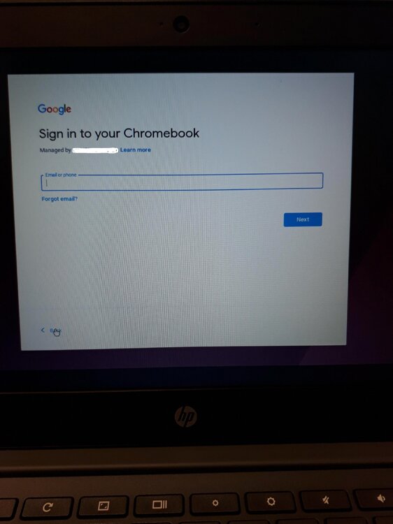

GoatSheep Posted May 14, 2020 Author Posted May 14, 2020 Thanks for the quick response. We were told to untick this by google yesterday. I have re-ticked it and will give it an hour to propagate. Below are the screenshots of what we are getting. This happens on a Chrome device and a browser.
RLR Posted May 14, 2020 Posted May 14, 2020 In the GCDS have you ticked the box to make new users set a password at sign in? 1
GoatSheep Posted May 18, 2020 Author Posted May 18, 2020 Morning, this setting sorted it out. I think the lesson we learned was that every time we make a change to GCDS we need to save it, close the program and re open then the xml file. Thanks.
